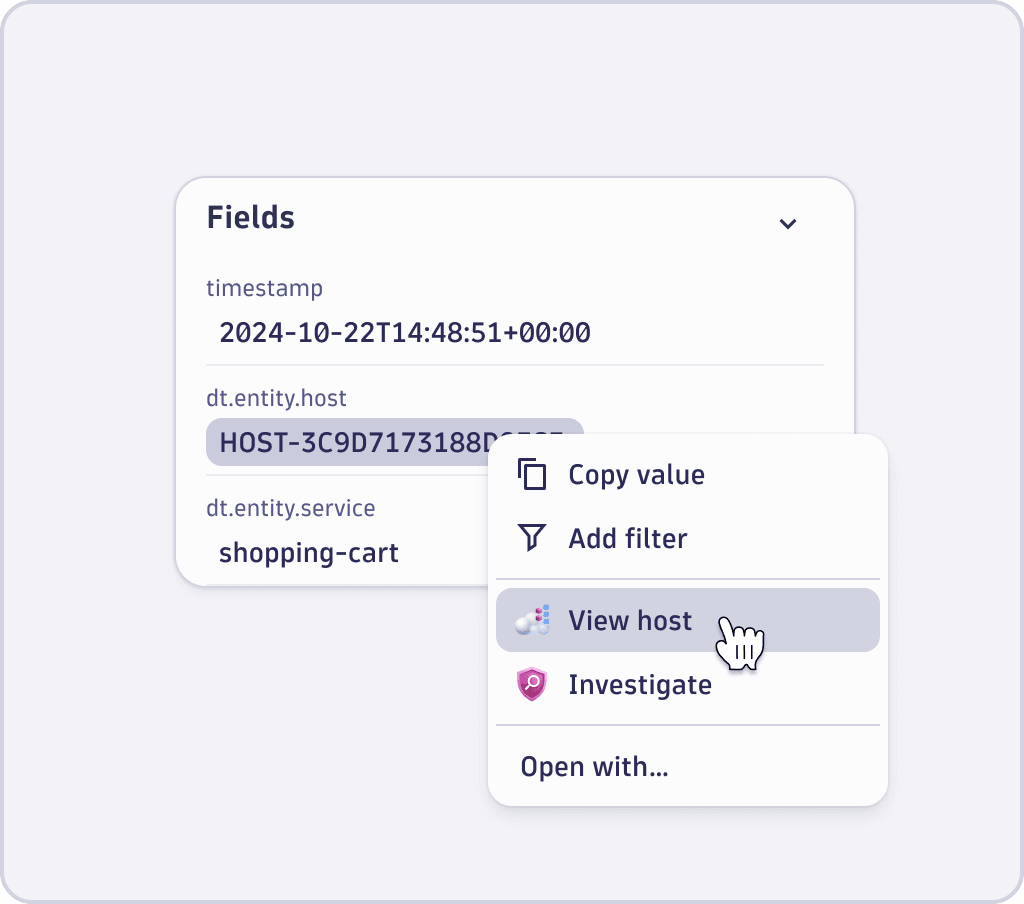

Explicit intents​
Use an explicit intent when your app knows exactly where to send the user. The user clicks, the target app opens with all context applied. No dialog, no choices.
An IntentButton menu opened on a host entity, with the explicit intent "View host" (Hosts app icon highlighted) as the primary action, "Investigate" as a secondary action, and "Open with..." as the fallback entry at the bottom
This is the most common pattern. It powers primary actions in intent menus and the left side of the IntentButton split button, the primary action such as View in Hosts or Open in Notebooks.
  • When to use—the target app and action are obvious for the resource type. You're connecting a host entity to the Hosts app, a trace ID to Distributed Traces, a DQL query to Notebooks. The 80/20 case.
  • How it works—your app calls sendIntent() with a recommendedAppId and recommendedIntentId, or uses the <IntentButton> with those options set. The AppShell skips the Open with... dialog and opens the target app directly.

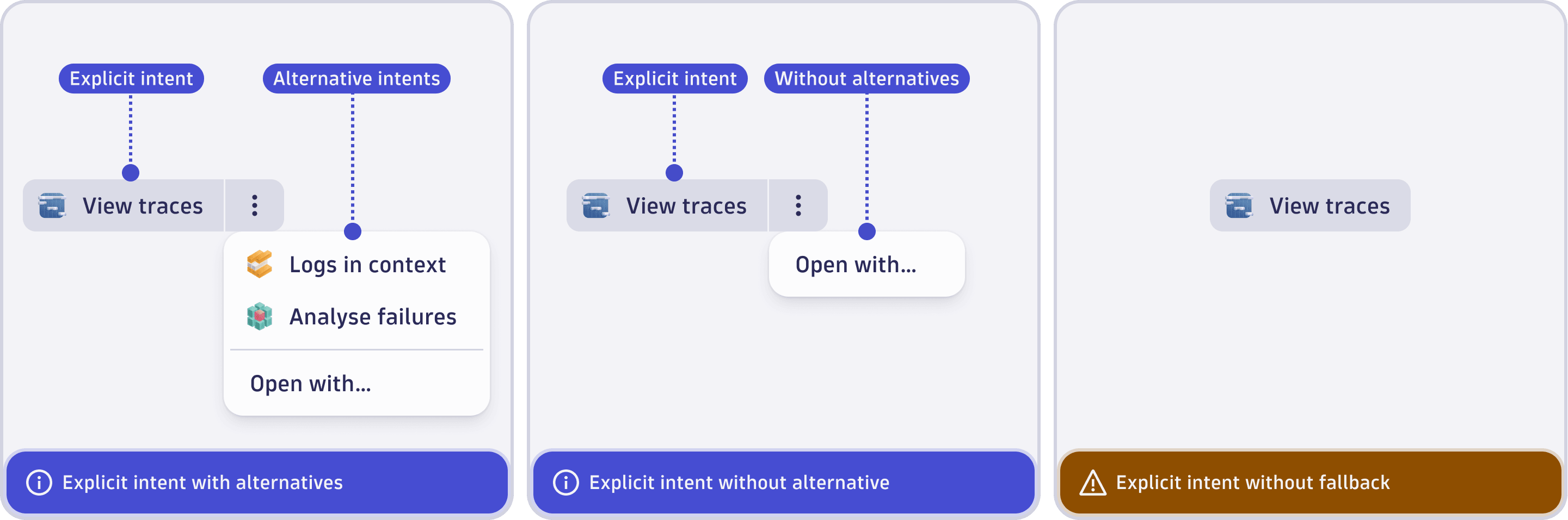

The IntentButton​
The IntentButton is a split button from the Strato Design System that implements all three mechanisms in one component. The left side triggers the primary explicit intent directly, for example, View in Hosts. The right side opens a menu with additional explicit intents, add-ons, and Open with... as the last option.
Three IntentButton configurations: (1) explicit intent with alternative intents and &quot;Open with...&quot; fallback in the menu, (2) explicit intent with only &quot;Open with...&quot; as alternative, (3) explicit intent without any menu or fallback
Use IntentButton for straightforward cases. Use sendIntent() from @dynatrace-sdk/navigation when you need more control over the trigger. For example, responding to a table row click or a custom interaction.
