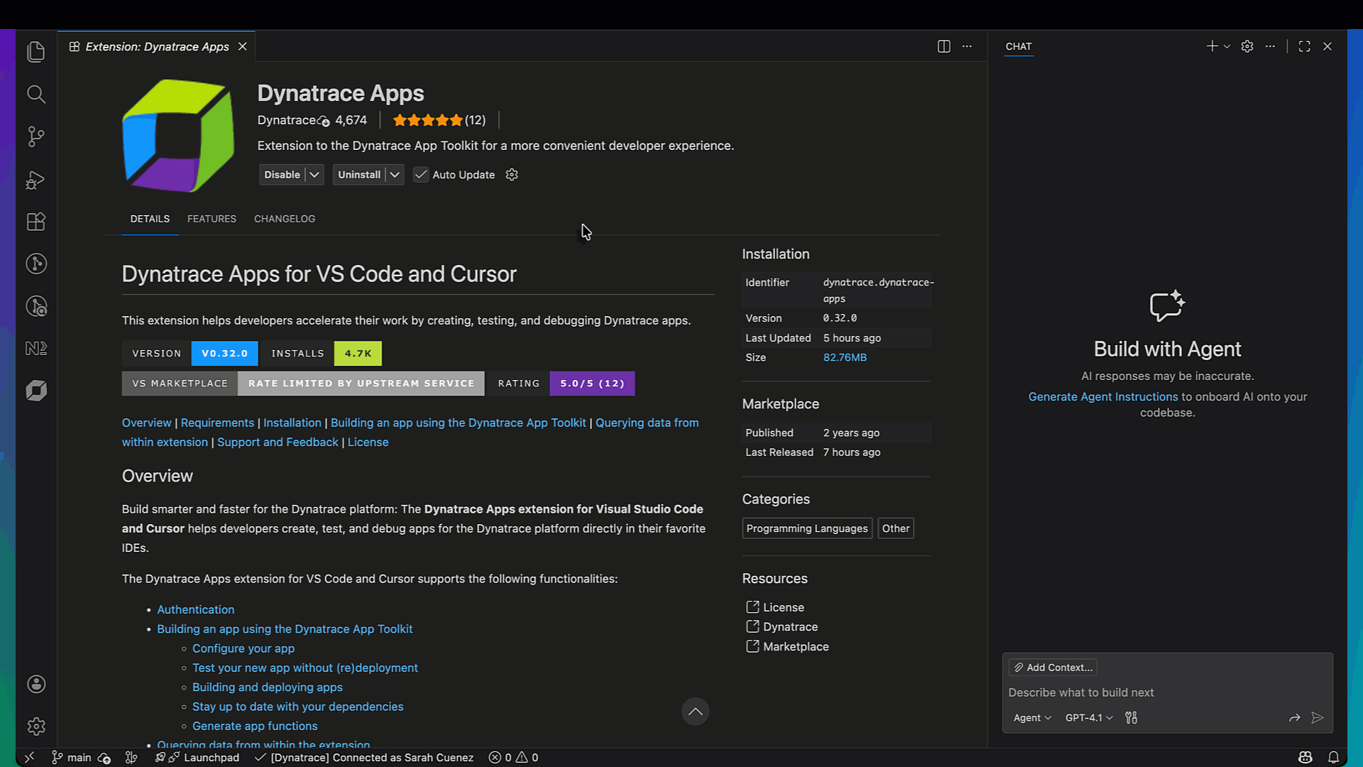

Step 2: Add the App Development MCP server
To add the dynatrace-apps MCP server, ensure you have the Dynatrace Apps VS Code extension version 0.35.0 or higher installed. The MCP server will be installed automatically—no manual setup required.

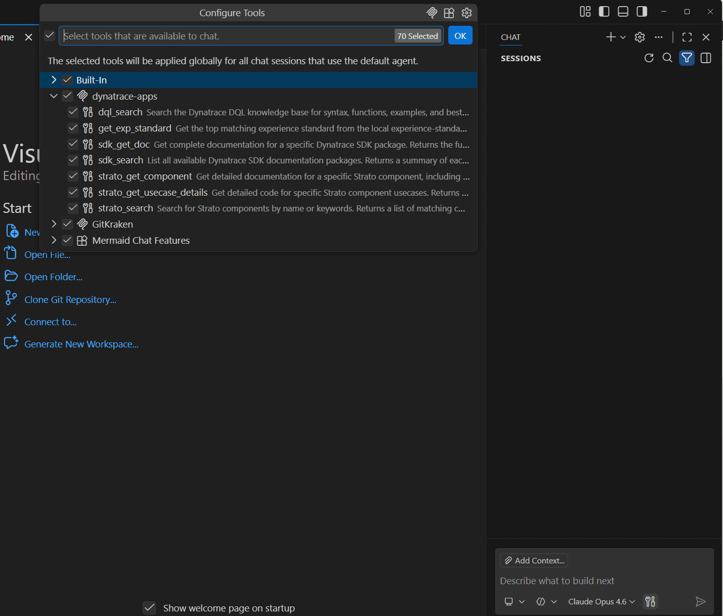

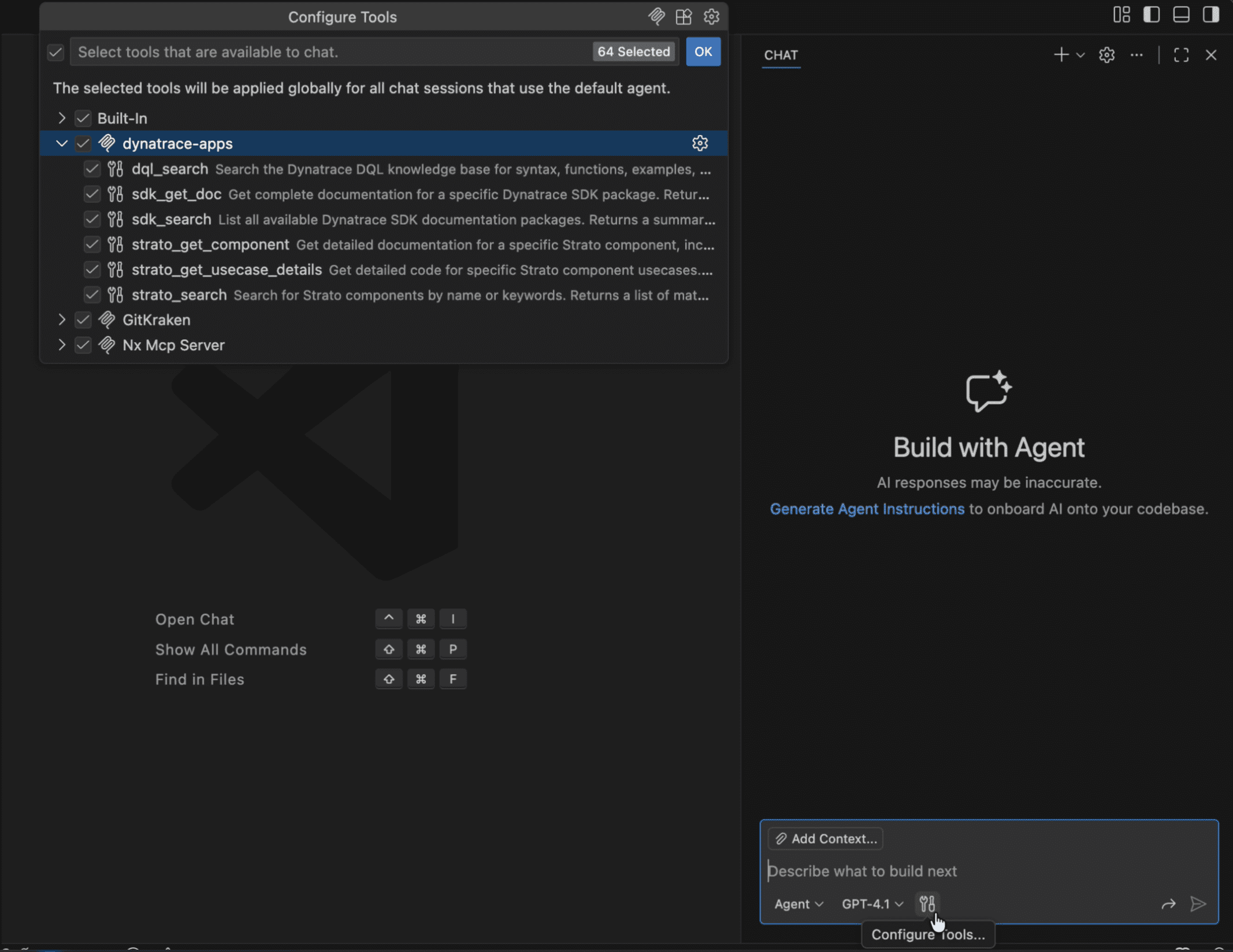

Step 3: Configure your AI tool
GitHub Copilot in Visual Studio Code
  • Open the Copilot chat window and select "Configure tools" to access AI tool settings. Configure tools in Copilot chat
  • Alternatively, you can open the MCP Server list by pressing ⌘⇧P (macOS) or Ctrl+Shift+P (Windows/Linux), then typing MCP: List Servers.
Make sure the MCP server and all available dynatrace-apps tools are activated. This enables AI-assisted development directly within VS Code.
